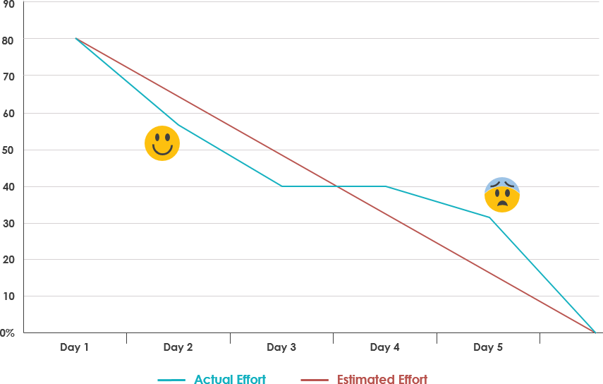

Burndown chart and emotion

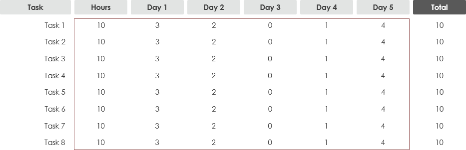

Step 2 – Track Daily Process
The daily progress is then captured in the table against each task.  It is important to remember that the value captured for each day is the estimated effort to complete the task, not the actual effort.
Burndown - Daily progress
Burndown – Daily progress

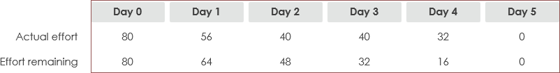

Step 3 – Compute the Actual Effort
The total remaining effort needs to be captured at the end of each day.  This is the total (sum) of all of the estimated time remaining at the end of each day.
Burndown - Actual effort
Burndown – Actual effort

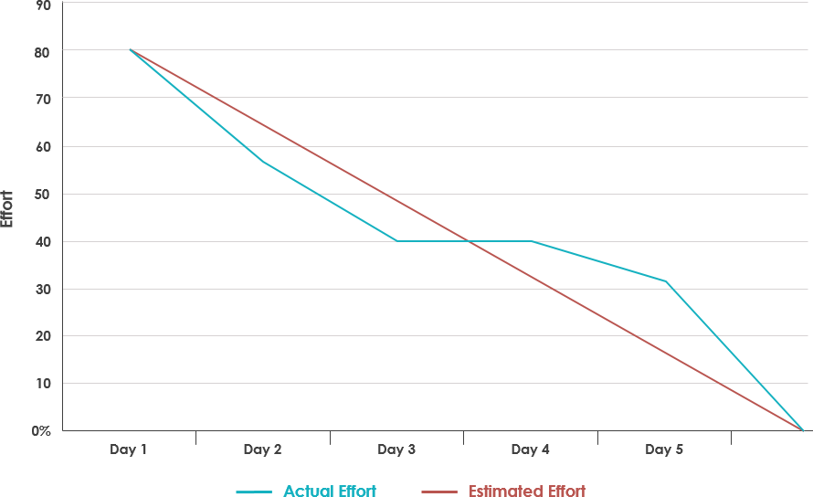

Highlight the summary table that contains the daily total for baseline effort and estimated effort.  You should also capture the heading of time period (Day 0, Day 1, etc).
Step 5 – Plot the Burndown using the Dataset
It is very simple to create a project burn-down chart as following, as long as you know what data you are tracking.
Burndown chart example
